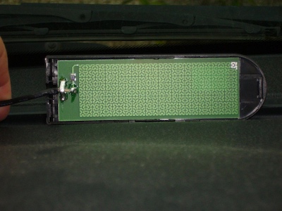

I have been doing some more road testing with the ViaM TMC, It really does hold a signal all over the UK, It seems to be working better than even the built in system in my car (Alfa).
Now I decided to have a look inside the antenna box to see if there was some fancy Amplifier also why it did not matter wich way round or the angle the unit is at the signal is always rock solid.
Suprise suprise, just a PCB with a dancy antenna pattern meaning it can be placed at any angle, no preamp just the PCB. So the TMC reciever in the ViaM must be much more sensitive that the TomTom or Garmin units and also seems to reject noice interference and false signals a lot better
Pictures

The amplifier may well be at the other end of the cable - ie in the viaM unit - this would make manufacturing sense as aerials would be cheaper to manufacture and hence cheaper to supply as replacements. Also no need for feeding power up the cable.
But it looks as if you have a neat system there.

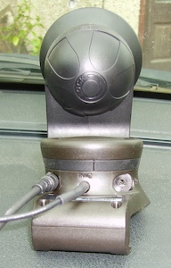

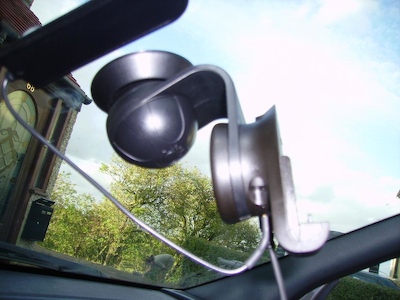

Sorry not very clear photos but here is a picture of where it joins the mount and the connector.
There is no connector on the back of the satnav for the antenna only the one on the mount

Wow that's huge, is there much windscreen left to see out of after you set it up?

Huge! Tell me about it,
After being used to modest Garmin and TT Mounts I almost fell out my seat when I took it out the box.
BUT it works it does not lose connection or fall off the screen lik the TT Mount, so it has its good points, just that its a bit of overkill (I did think about using it at home to mount a 32" LCD TV Laughing )

Thanks for the photos Vicky.
The mount looks almost identical to the X980T mount, but I've only got 2 connections / sockets, one for power and one for audio input I think. There is a clip out cover marked optional underneath where your antenna plugs in, underneath is a 20 pin connector but I haven't got a clue what it's for.
Mike

Here are some better pics of the connectors on the 970 and the mount
There is NO TMC Connector on the 970 at all only on the mount
