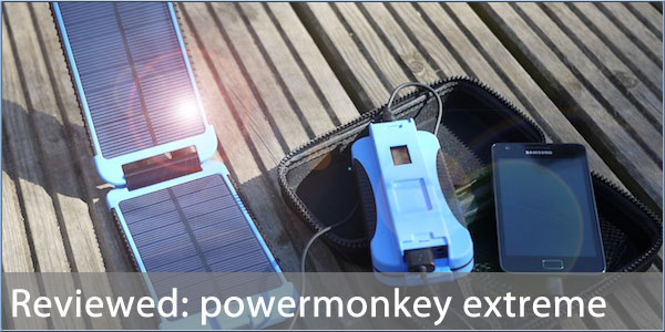

Powermonkey have earned a reputation for no-nonsense portable charger and power solutions. They're designed for travellers and are built with portability and ruggedness in mind. Their catalogue of products ranges from small battery packs intended to recharge your mobile phone to monster packs capable of running a power hungry laptop for hours.
Regular readers may recall that we have reviewed a Powertraveller product previously. Back in September 2008 I came across their powermonkey explorer in the in-flight magazine on route to Dubai. I was sufficiently intrigued to splash out real money to buy one for testing and it was an instant favourite of mine.
Fast forward a few years and we now have a much more powerful version in the powermonkey extreme which we are reviewing here.
