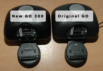

If you are having problems with coated windscreens and satellite reception with your new GO 300 then make sure that you order the correct part. External Antennas for the original GO DO NOT fit the new GO 300.
The above picture shows the 2 mounts side by side. The connectors for the new GO 300 are located further back on the mount.
The above image shows the difference between the connectors of the new GO 300 and the original GO. You can see that the GO 300 has just a single connector towards the back of the unit whilst the original GO has 2 connectors.

PostPosted: Fri May 06, 2005 4:18 pm    Post subject: Reply with quote
It looks like the old one will fit the new one when it comes out, just not the other way around.
PostPosted: Fri May 06, 2005 4:47 pm    Post subject: Reply with quote
Although the original GO will fit into the new mounts I would be very wary of doing so. The connectors on the back set have different functions and it may damage the original GO to insert it into the new mount.
If that is what I read your answer to mean.

Hi,
Just thought you'd like to know that you can modify the new GO 300 mount to include the external aeriel from the old Antenna kit.
Here's what you need: 1 x Torx T6 Screwdriver, 1 Torx T8, 1 x Tomtom GO External Antenna (Part no. ID00.001).
Method:
Peel back the thin end of the rubber pad on the bottom of the GO external antenna mount to locate two T6 screws. Remove these and unclip the base. Underneath you will find a metal plate with two T8 screws in, remove these and the plate comes off. Rotate the top of the mount and it pops out from the base. Underneath the metal ring are two more T6 screws. Remove these and take the plastic plate off. From here you can remove the aeriel connection from the top of the mount.
Repeat the above process to disassemble the mount for the GO 300. On the top of the mount, where the connector is, peel off the black sticker around the connector and you will find that it covers a hole already there for the aeriel to fit in (the mount contains all the fittings for the external antenna). Place the antenna into the GO 300 mount and re-assemble.
Hey Presto! Aeriel mount for the GO 300 for those who don't want to wait for Tomtom to release the new kits. Did this today as my car has an Anti-Thermic coat on the windscreen, now have a brilliant signal all the time.
