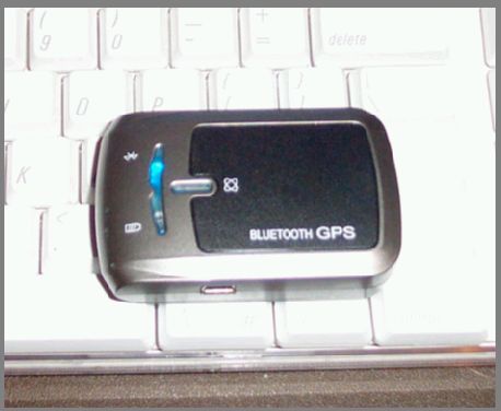

Here is a short user review (by kar98) of the first Bluetooth GPS receiver that featured a MTK chipset and the Bluetooth Sleep function.
OK, the Christmas season is over and wandering through the computer stores, I noticed that nothing they had for sale excited me the least bit. Already got every gadget known to god, man and beast; and better, faster, slicker to boot.
Nothing exciting in the PDA aisle, no fancy new iPods, the cellphone shelf looks plain depressing and seeing how I just spent $350 at the auto-glass place, car stereos left me yawning, too.
So I got my hands on a i-Blue-737 Bluetooth GPS receiver, made by Transystem in Taiwan. The unit is also sold as ITernet PS-737 and as QStarz BT-Q810.
The receiver does not impress with fancy design gimmick, but what’s under the hood is what counts anyway. My first exclamation of “oh, nice!” was at the discovery of the rechargeable battery.
It can be replaced by the user, without the use of any tool and it’s the same as in my Nokia 6030 phone: a 1000 mAh Li-ion job that promises 25 hours of usage, after which it can be recharged in 3 hours by connecting the receiver to the powered USB port of any computer, a wall charger, or to a cigarette lighter-to-powered USB-port adapter.
As far as I was able to determine, the mini USB port on the PS-737 is for charging only. When connected to a computer, it shows up as “CP2102 USB to UART Bridge Controller”, but that’s it.

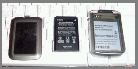

Swiftly we rip the unit apart:
The bottom lid, the battery, and the matchbox-sized receiver. Neat feature: the black rectangle at the bottom is a rubber pad, presumably to stop the receiver from scooting all over your dashboard while driving. Nice. The battery is the same as in many Nokia phones (BL-5C), enabling the consumer to replace it for about $20.

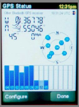

If you have ever paired one Bluetooth device to another, setting up your PDA or computer to work with the receiver shouldn’t confuse you either. While I completed that process, the device busied itself finding its position in the known universe and we finished at the same time, after a tad less than a minute:
Better than -158dBm sensitivity in the palm of your hand! That’s indoors, by the way. Outdoor performance was outstanding. Driving through the same landscape that used to baffle your ancient SirfStarII receiver of yore --winding country roads with lots of huge trees, valleys, shopping malls, tall office buildings downtown-- the MTK chipset in this new receiver typically showed twelve satellites reading 8 to 12 of them at near full strength.
In comparison, the SSII (Pharos iGPS360) was lucky to barely read 3 or 4 out of 6, and the very good TomTom MkII (SSIII) typically received 7 to 8 satellites and used half a dozen of them. Coming from a company I hadn’t even heard of yet, the MTK chipset’s performance is impressive indeed. Also, there doesn’t seem to be much of a “sway”, i.e. when standing in place the receiver will not show you wandering around in a 15 foot radius. Likewise, barely any deviation from your actual path either.

Do you know if the battery is removable? Does it use the nokia type like a lot of the other units?
Well, considering that there's a picture of the disassembled unit posted above, with the battery removed, and it even states explicitly and verbatim the "battery is the same as in many Nokia phones (BL-5C)", I guess we'll never know.
