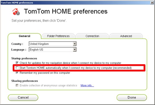

In HOME:
Tools | Preferences
Untick Start TomTom HOME automatically when I connect my device to my computer (recommended)
Click 'Done'

richard345
Joined: Mar 09, 2008
Posts: 463
Location: Rainhill, Lancashire Not Merseyside!
PostPosted: Tue Mar 31, 2009 8:27 pm    Post subject: Reply with quote
In HOME:
Tools | Preferences
Click 'Done'
Darren, this didn't work for me, regrettably with Win XP Sp3. I thought it woud have sorted it, but no such luck Crying or Very sad
