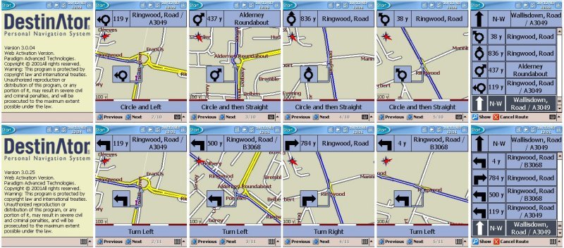

I have spoken with PowerLOC, and although they believe this is a map problem which they are trying to rectify, I have carried out some extensive testing between versions and I can confirm that the problem IS WITH version 3.0.25 and have notified PowerLOC of this.
Take a look at the screenshot below to see the different. The top screenshots are from 3.0.4 (as we reviewed it), and the bottom screenshots from 3.0.25. Spot the difference, it looks like PowerLOC have by accident left out the roundabout code in 3.0.25, either by going back to an earlier source code and adding modifications to make it 3.0.25, or it just hasn't been included modularly in 3.0.25.

I am awaiting information back from PowerLOC regarding this, but it would seem that it should be a quick/easy fix rather than having to re-issue all the maps for the UK (like as some of you may recall TomTom had to do with TTN2).
